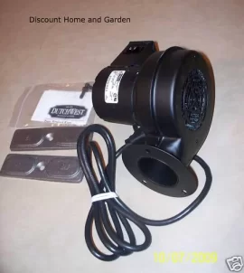

I have a 2461 and was trying to locate a blower for it, I see you mentioning it in this great thread. I see it referenced in the manual but it doesn't show any part number and I'm trying to source one and see more pictures of what it looks like. If you have a p/n or any other info that could help me in finding where to get one it would be great.
Also, I see you referenced a top - down load or start, what does that mean?
http://www.electricmotorwarehouse.com/fasco/fasco_blower.htm .. Look at 50747-D401 the important thing is the blower flange diameter.. I am pretty sure I have the Dayton 4c440 on my stove and added a bat handle toggle switch to it at the motor junction box.. I also drilled the flange to reorient the blower.. Oil it once or twice a yr. and it will last you a decade..
Or look here: http://www.electricmotorwarehouse.com/dayton_blower.htm and look at blower 1TDN7 ...
Ray
Welcome to the forum kpauley,
The part #for the cdw fan kit is 0009973. This is without the rheostat. (Dutchwest Stove Thermostat Blower Fan Control Part #000FT1)
I wish I had the rheostat on mine. But like Ray said, you can adapt other fans to this stove, in some cases the fan may even be a better fan than the ones they sell for these stoves. Although, I've had no problem with mine at all, and it comes with the block off plates for the bottom of the stove where the convection air would come in. With the fan on the 2461 you need to block off these inlets in order to blow the air out of the intended outlet.
Top down is kind of like starting a fire in reverse. Big splits on the bottom and smaller at the top with kindling to top it off. This lights the fire from the top of the pile and spreads down. It is great, because you don't have to add splits to the top of the fire, which often smothers the fire, killing its intensity. I sort of use a modified top down now, two logs front and back, kindling in the middle with increasing kindling to small splits on top. Laying small kindling bridging across the two logs and building up from there. The top down fires are great, though, because you generally don't have to add anything to it once it's lit. They take a little longer to generate heat but are more hands off once started.
Glad you liked the thread hope it helps you! Here's a picture of what the fan looks like:
