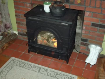

Well the only thing missing is an updated picture of the stove!

  • [Hearth.com] VC Dutchwest "Large Cat" 2461, my diary thread (w/ pics)
