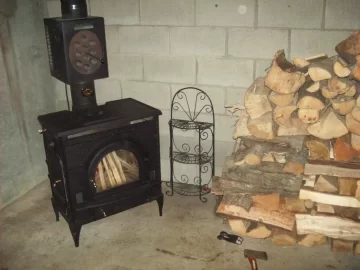

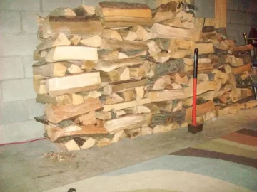

Get a face cord of your semi-seasoned wood down in that heated dry basement of yours to dry.
I remembered our first conversations we had about dry wood and the Dutchwest and I just knew that's what you would say. I read your mind, Firewalker. It looks like this, minus the heat heat reclaimer, until further notice.

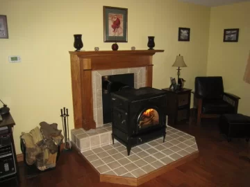

Ok. I think I have this figured out. The first photo is our install, and the second is a close up showing a start-up after cleaning. I was a non-believer in the top-down starting method until I tried it. Now I am a convert!
Great looking stove enjoy! That would be the extra large convection I think.. Huge firebox and very efficient too! I heat 1632 sq. ft. with the large convection..
Enjoy!

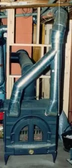

I have wasted a lot of heat without the MH connected to the pipes. I may instal it before the end of the burning season. It really helps to harvest the heat and heats the house with less wood cunsumption.
