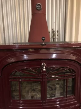

Woody5506: I saw another post that said not to put water. Why and what kind of problems would it cause? Other than smoking and steaming. I had closed off all air intakes, but didn't realize at the time that the ash drawer was not shut tight, thus I was having air intake but didn't realize it. The thermometer is on the stove pipe about a foot above the stove. It is a "HomeSaver Stove Thermometer".

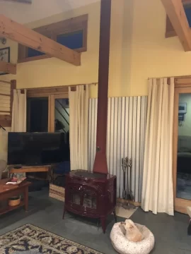

Dobish: Funny you mention a change in the wood! I actually just had a wood delivery the day before the incident. So I thought maybe the new wood was not as dry as the old? I ran a test with a piece of the old and a piece of the new with the same results. I'm glad to hear I probably didn't damage the stove. Interesting about the ash pan. It always seemed to me that when it was full it wasn't burning as well, but maybe that's a good thing that it burns slower. I understand about the 2 levers - it took me a while to understand and I turn them both down once it gets going. I do not, however, understand about the catalyst. I thought I read that not all of the stoves have one? Having never used a wood stove before, the concept of how they work took a while to understand.
Diabel: the stove is a VC Encore. The pipe goes out the back and up to the ceiling which is maybe 15-20 feet? I'm primarily burning kiln dried split logs of various sizes that I had delivered. There is a woodshed that has wood in it that was there when I moved in. That wood is seasoned and I mix in a couple of pieces each day to try and slow the burn down. But that entails getting the wood from the shed to the house and I'm not always up to the challenge! (the new wood is stacked in a screened in porch).
I'll post a couple of photos.

My 6" flue chimney plugged up 2.5 months after it was cleaned. So yea it can happen it that period of time. I've found for the cat to function as intended the cat probe should read at least 650 or so.
When you empty the ash pan make sure you are sweeping all the ash out of the chamber. Ash generally spills over the pan and can accumulate in the back not allowing the door to close properly. How are you testing your wood as well? If there is a change in the burn at the same time as you switching piles this could be your issue. Often kiln dried wood is only in the kiln long enough to kill off the bugs. I don’t know this first hand but have read it here many times by trust worthy members who know much more than myself. Have you gone back to the shed to get a stove load of that wood to see if it burns like you are used to seeing?
And at 10 years old with no knowledge of prior maintenance I would be replacing some gaskets (ashpan, griddle top, glass, doors). Probably even replace the cat and get a cat probe. Welcome to world of a VC owner. It can be frustrating.
So you were saying that it is having a hard time getting enough air even when the damper is open? If that’s the case then yes, it’s probably the wood. If, however, it’s having trouble breathing while the damper is closed, there is the possibility that ashes Settled on top of the catalytic combustor ( assuming it is a catalytic stove), or that pieces of the combustor broke when the water cooled it too fast and they are restricting the air flow. You can look at the top of the combustor to see if it is in good condition by putting a mirror through the slot in the back of the stove and looking down at the square honeycomb holes to see if they are open.
From your description, though, My guess is that it is the wood that is different.
Your stove should have a catalyst in it. When it is cold, open up the back doors and there should be a piece that looks like this: Behind that will be your catalyst
