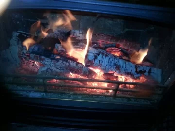

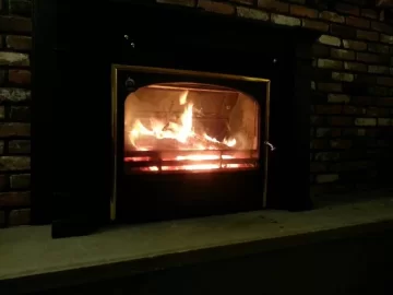

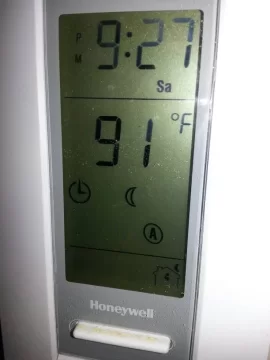

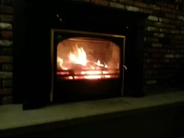

Im using the condor stove top thermometer. Meter shows 450 temp for the stove. My living room has 2 fans running, one pushing cool air from the kitchen, the other pushing warm air out of the living room. Its 91 in here and 83 on the opposite side of the house. Granted my house is only 960sq feet not including the basement and its 40 degrees out, but I think she is doing a good job.

It certainly sounds as if you are warm enough.:)
