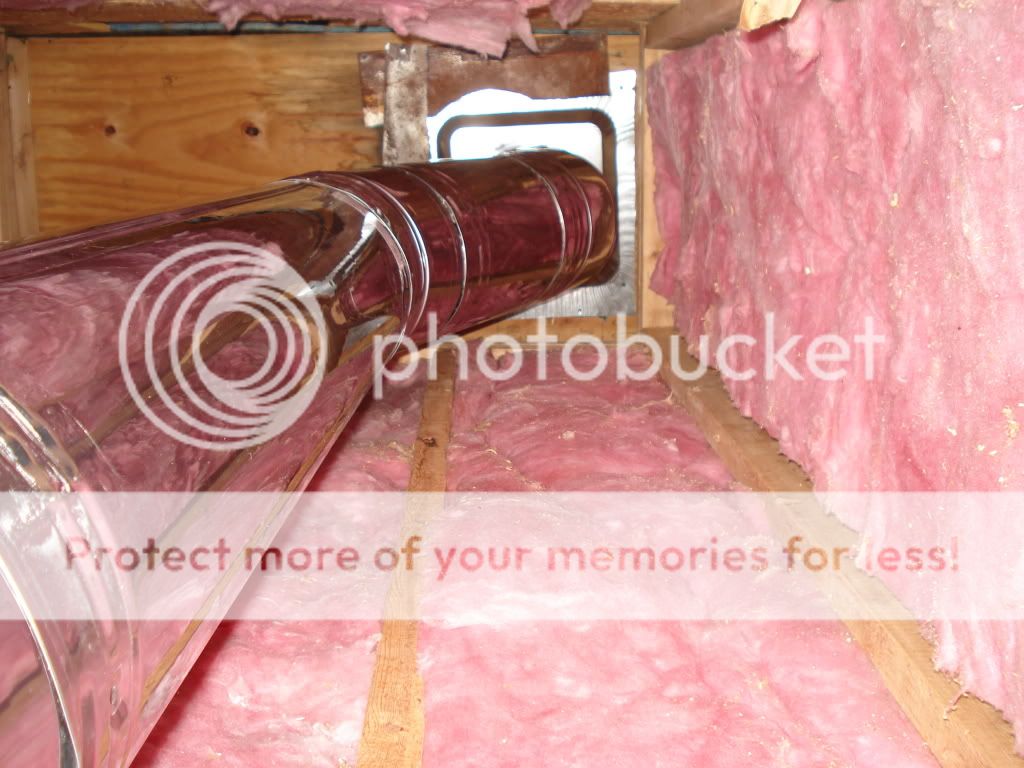

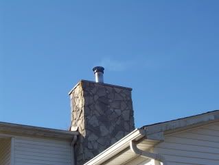

    I took on the same project a few years ago. I had a superior fireplace insert venting into a double wall galvanized flue that was inside a wood/vinyl sided chase. I came to the conclusion that a insulated liner inside the existing flue wouldn't be up to code. I elected to tear out the existing metal flue and replace it with a 2100HT Class A chimney system, making sure the exterior of the new pipe was never more than 2" away from combustibles. The pipe wasn't cheap but It was fairly easy to install.

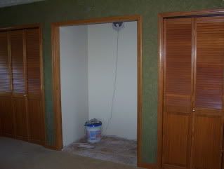

    I elected to demo the entire ZC and go with an alcove:

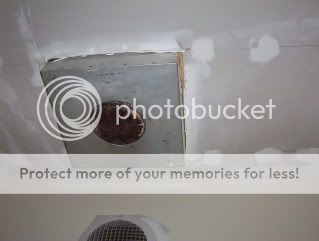

    I simply used a ceiling support box for the Class A chimney in the new ceiling of the alcove:

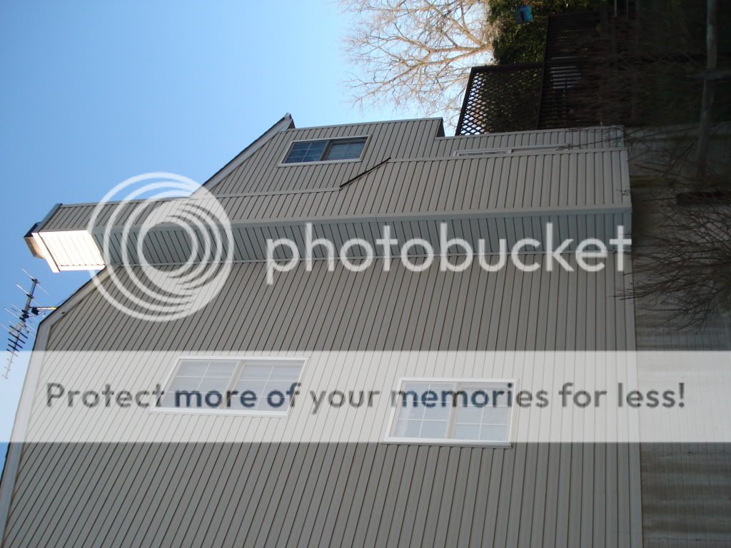

    And ran the class A up through the existing chase where the ZC Vent was originally:

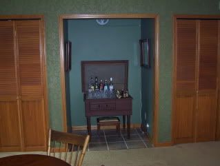

    In the summer the stove goes out and I put the bar in the alcove:
