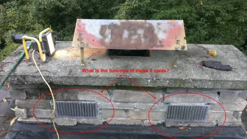

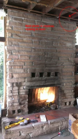

My 'modern' house was built c.1958, with a big sandstone chimney on one side, and a heatolator type of fireplace (double-walled metal firebox, air inlets down low in the living room chimney to allow cold air in, with tubes to circulate warmed air into the living room). Above the roof the chimney chase has two vents on the side. What function do these chase vents serve? I'm just curious, and want to make sure I don't mess up their function.

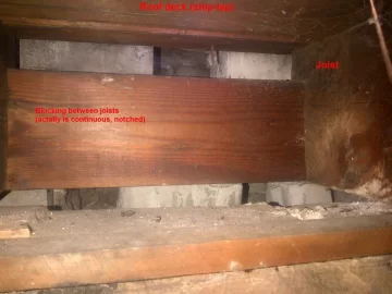

The house has a nearly-flat roof, no attic. I'm wondering if the vents have nothing to do with the fireplace (nor chimney, really), but are there to vent the thin space between the ceiling and roof (2x8 joists)? (I.e., simply taking advantage of the chimney as a convenient 'doghouse' to vent up into, and perhaps using a little chimney warmth to help pull moist air up and out of the 'crawl space' between ceiling and roof, to prevent the roof deck from rotting. I'd be happy, if so!) The ceiling is currently removed, as shown in the second-to-last pic, which shows the joists (and furring strips) up high. But perhaps the vents serve a chimney/fireplace function?
(Per my pics and postings on another thread here, I've installed a 1986 Avalon fireplace-insert, cut out one of the heatolator tubes to make room for a stainless-steel chimney liner, insulated, and filled the empty chimney flue space around the insulated liner with Roxul.)
The chimney vents are not connected to the flue, obviously. But I don't know where they connect to, nor what purpose they serve. (I haven't opened up the vent covers to look down.) I don't know much about chimney construction, but obviously they are there for a reason.

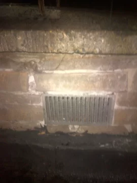

Some pics here (let me know if I need more to make it clear). The last pic is at the ceiling-level, looking in toward the chimney, with a joist on the right. My hunch may be right: these vents are just to vent out the mini 'crawl-space' in the flat roof! Nothing to do with the fireplace.

in that last picture are those openings into the structure of the chimney? if so can you see the liner in there?

The last picture is looking inward to the chimney at the ceiling-level, on the right-hand side of the chimney; but the liner is safely encased in a flue. (Inside the flue, the liner is surrounded by insulation and Roxul.) I've clarified this by putting the photos in better order, and marking in the bigger photo where the closeup is taken from.
It's hard to look in and hard to get any better picture, because of the 'blocking' and joists. The joists and 'blocking' are notched to interlock, the blocking is two 2x6s (I think) on edge. The unmarked board in the foreground is like a top-plate, sitting on top of a ledge of the chimney. The chimney narrows before it goes up through the roof.
by encased in a flue are you referring to a clay liner or is it a masonry structure? And then i assume you dropped an insulated ss liner down it correct? I have no idea what those vents could be but the only thing i can say is pull the covers and look in there with a mirror and light to see what is there.

Odd. Chase vents for condensation is all I can guess.
Reactions: LiamK
Yeah or they are using that for part of the roof ventilation but it is weird

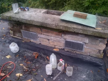

"Chase vents" (thanks for the proper term!) -- yes, I've wondered about condensation. I'm in the rainy Pacific Northwest (where flat roofs were a bad idea). I'm trying to think where the moisture would come from (interior and/or exterior, depending on the season), and where it would condense (and why). (We don't have A/C.)
I think the flue is a masonry structure, not clay. (I don't see any smooth red clay or tiles, and the inside where I can see appears to be masonry cement.)
Yes, correct, an insulated stainless-steel 6" round liner connects all the way from the fireplace-insert up through the chase-cover (about 12' length). The ss-liner is insulated. Then, around that the 11"x15" rectangular flue is filled 'solid' with Roxul rock-wool (a roughly 7" hole cut into 11"x15"x5" rectangles of Roxul, pushed down over the insulated ss liner, repeated until flue was filled).
Good idea to use a mirror! I hadn't thought of that, doh. :( I've been hesitant to pull either vent cover because the mortar is old and seems a little fragile. (Repointing is way way down my list of home rehab/repair priorities -- insulation, drywall, trim, paint, floor, and new electrical come first.) General principle of "if it ain't broke, don't fix it." But you're right, worth a look.
If the vents are for roof ventilation (not for the chimney per se), I'll be very happy, because roof venting is highly recommended for low-slope/flat roofs, especially when putting in insulation. This article by Martin Holladay in GreenBuildingAdvisor is excellent: (broken link removed to http://www.greenbuildingadvisor.com/blogs/dept/musings/insulating-low-slope-residential-roofs?page=1) He strongly recommends having one or more vented cupolas ('doghouses'), “You can build a 2' by 2' doghouse that sticks up a few feet, and put in some rectangular vents." These 1950s houses were built with zero ceiling insulation. When you put in ceiling insulation on a low-slope/flat roof, you cannot fill the joist (truss/rafter) area entirely, or else moisture builds up and quickly rots the roof deck. Ideally, there should be a 6" gap between the top of the insulation and the roof deck/sheathing, to allow the moisture to diffuse and transpire. With 2x8 joists, hence only 7 1/4" to work with, using 3.5" insulation and 3.75" of air gap is a compromise. (When I can afford the $20,000, building a second-roof and rigid-foam insulation is the way to go. When I can afford it, a new house is an even better way to go.) Putting in a new doghouse would be expensive and would risk creating a weak spot for possible future water leaks -- the bane of flat-roofs. So if these are in fact roof vents (to vent moist air out from the ceiling-to-roof area), then I will toast whoever designed and built them, 60 years ago. That they don't serve an obvious chimney/fireplace purpose, to the expert voices here, is very helpful to know.
