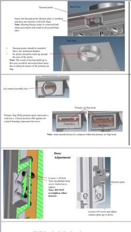

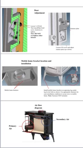

Look what VC provided me. We knew much of this already, but it validates what has been said about the system. But still no luck in getting “acceptable” temperature limits. They didn’t budge on that request. I reviewed every number and every word in the third party test document done a few years ago. They do reach temps into the 800s.
Did anyone notice any warpage in your refractor board? It was sitting perfectly flat on the side rails and the back when I got it, but it’s not doing that now. I’ll post a picture this evening.

Thanks for sharing that VC documentation!
I have not noticed any warpage in my baffle so far. I just took a look. I have not had enough fires to say it won't happen, though.

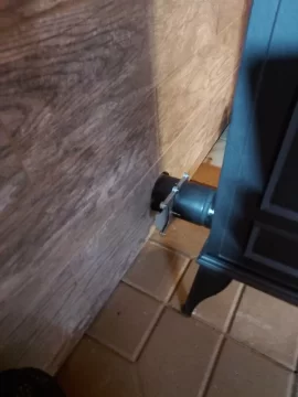

Installed an aluminum blast gate on the cold air intake. By varying the opening I can control it to any temp I want. Before I installed the gate, I marked it to determine precisely how far it is open. Have run it a couple of times checking the temp every 10 -15 minutes by IR. At just under 50% open the stove seems to be running well. Stove top temp runs 500 - 550, center of cook top 550 - 600, flue temp up ~ 18" 350 degrees.

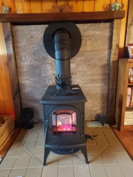

I also set up a small fan by the stove and tied it into a temp controlled outlet. Setup seems to be working will. I still have only loaded the stove about 1/2 way. Waiting for colder weather for the final test, but am pretty confident this setup will work

That looks great! I think we may be on the right track regarding controlling the cold air intake a little more. A blast gate may do just the trick.
Is the fan meant to provide some extra draft towards the cold air intake when the stove cools down and needs a little more air to burn a little more, even though you may not be around or asleep to manually open up the blast gate?
I probably would worry about putting a damper on the flue rather than controlling the intake air.
Reactions: EddyB
The fan is simply to move more hot air around the room once the stove gets hot, instead of just relying on natural circulation. The air intake runs thru the blast gate and then out thru the outer wall so that I am drawing in outside air, not air from inside the house.

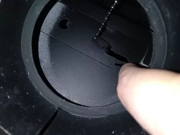

So, before I go and really push the issue, I was wondering if the Aspen owners could tell me if the flap on your cold air intake is completely closed at the hotter temps on your stove. I know some of you have external air intakes and can’t really feel the gate to see how open or closed it may be, but if you do know, could you give me some feedback. It would be so appreciated.
Perhaps all that needs to be done is disconnect the chain, lengthen or slacken it a tad, then reconnect it. Not sure. It won’t be me doing it because it’s a brand new stove and the retailer should be taking care of the problem.

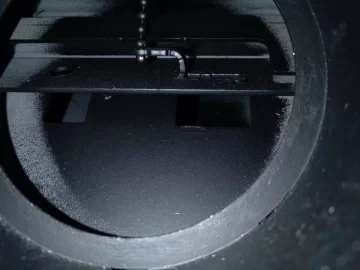

My intake damper is completely closed - like resting completely flat against the big plate it's mounted on - by the time my cooktop center hits 550 degrees or the insulated spot between the cooktop surface and the flue exit hits 470 degrees. I would expect this to vary somewhat depending on how fast the fire gets up to temp from cold as the probe for the bimetallic thermostat that pulls on the intake damper chain is sitting between the insulation blanket and the top casting of the stove, so really it's whatever temperature that gets up to that sets the flap closing. I am reading from the outside of the stove so it's a bit of a secondary reading and there's somewhat of a delay.
Regardless, it should be completely closed at higher temps so that the only air that can get in is through the two holes in that intake damper. Sorry for the terrible pictures but the one with my finger in it is what it looks like when the stove is up to temp and that intake damper is dropped flat against the big plate. I have verified this visually and carefully with my fingers on my last couple of burns (the intake stays pretty cool at least on stove startup... No promises after it's been burning for hours, ha).
If your thermostat/chain are not letting it close down completely flat then I would say something needs to be fixed.

So, the dealer is going to come and somehow extend the chain coming from the thermostat at the flap in the air intake. Not sure if there is enough slack there to do that, but that’s the plan I guess. He thinks that should allow the flap to sit down all the way closed. Then we’ll take it from there. But, if I can get that much wood into the stove without causing a major increase in temps again, then I will be very content. Thanks Mike!
