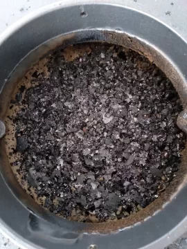

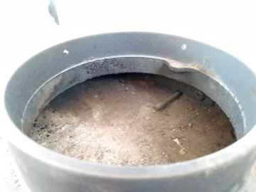

I wanted to add something to at least check off the list for anyone that is experiencing very hot burns. Pull up your stove pipe and make sure your temp probe is not buried in ash/creosote. It will take longer to get up to temp because it's effectively insulating it, and therefore close the air intake later in the burn. Pics below show the accumulation that had flaked off the inside of my flue (and this was before any cleaning). I attribute this to my early cool break-in fires, an occasional piece of honey locust that probably had higher MC than I initially thought, and my general learning curve getting used to how to run the stove.
The stove will still sometimes briefly run up to around 900 on the cooktop but not for long and I don't worry about it, from the prior discussion in this thread. After cleaning this stuff up, it is noticeably quicker to shut the air down as the flue temp comes up when starting a fire.
I'd also note you probably don't want to vacuum this stuff out as that would probably destroy the insulation blanket. I carefully scooped it out with a narrow putty knife.
View attachment 291541 View attachment 291542
I use a very gentle ash vac on my insulation blankets and such. A shop vac would definitely be too much.

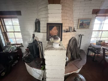

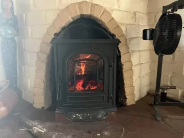

I bought a V.C Aspen C3 woodstove because it was a size and shape I could retrofit to our Secondary Kiva Fireplace (long story lol) a contractor friend and I installed a 6 in smooth wall stainless liner into our 7-1/2-7 3/4” Ceramic tile liner (Tight fit!!!) inside a adobe chimney which is Very thick 20 ft from chimtop to damper (which I painstakingly removed. fun job) area connected the existing outside air which was a bit smaller than the 4inch stove air intake. Prob about 1-3/4”x3-1/2-4” thru wall to outside. Connected liner with one adjustable elbow very securely. The two kivas are in a half circle really kinda back to back (the smaller kiva is holding the Woodstove) and the individual chimneys terminate on roof right next to each other at close to same height. woodstove chim is about 3-4 inches lower than the open large Kiva. They terminate at only about 24-26” from the Parapet on the flat roof. So all that said here are our issues.
Also the buffer closing off the liner 12-16 inches above stove where damper shelf was/is is probably the weak link. The area around liner stack was stuffed with ceramic glass insulation then a kinda poorly cut tin closing it all off. Probably NOT airtight the top of the chimney also is wrapped with this insulation. Prior to sealing w a proper airtight/water tight stack cap.
1- the stove as you may know has now draft control it’s all automatic inside stove. Nice idea but leaves us helpless regarding controlling draft. It is quite difficult to start the fire as per draft issues and it takes quite a while to get it to take off. Then we must wait till the coals are completely burned down too a “Perfect point” of super hot still standing and glowing to open stove or we are overcome by smoke pouring out of the front of stove while loading. That’s all good to some extent now that I have learned the trick of waiting for perfect reload coaling. I have burned wood all my life but not with a fancy stove like this lol. Big Standard Oil barrels stove mostly. Love those beasts lol. Miss em.
2-Last night we decided to have a fire in the in the large open kiva. It’s was great for a while then it started gentle back drafting and kept it up no matter what I did. Very subtle but so we were totally miserable to the point I had to cool with water a larger log I had burning and throw it out in the driveway and shut the kiva fire down and let coals burn out. Really fun.
3- we had tried burning the two kivas once when we had company to show off lol. Same thing happened. Not possible but I could not figure out why? Both have individual outside air intakes.
4- stove burns slow and steady and when it is really cooking at a medium high heat there is little to zero heat coming out of the stack on top. Though there is some sign of hard glassy creosote on exterior of stack so I imagine the inside is building more of the same telling me we have a poor burn going on. I burn very dry dead down dinosaur bone dry Oak using pine kindling.
We thought about extending the chimneys a foot or so just to see if it needs more height.
So this all said we would love your opinion and would love and happy to pay for a phone consultation if ya think there are things I can do prior to a possible in house inspection which may result in pulling stove and inspection auto draft chain adjustment or measuring for a better draft buffer above stove. Here are some photos showing the stove/kiva on left and large open kiva on right. I may add that we heated last year with the large kiva maintains fires that heated the whole kiva mass adding g to keeping house warm.

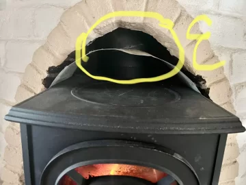

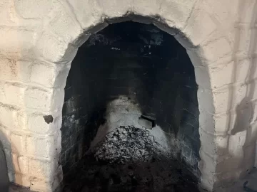

Photos. You can see elbow connection circled yellow. You can see glass is continually blackened even more than this photo which is about as hot as it gets.
Thanks so much. “

Forgot to add arrangement photos

There’s alot in that picture you described and the chimney seems to be problematic, especially where you retrofit into an existing chimney that’s been there for awhile and having issues in itself. I know what I would be told here if in the same situation - install a new chimney completely, out the wall and up outside, or straight up through the roof. This way you know what you’re working with and it’s easily accessible. It’ll be. interesting to see what they say. One thing is certain, if you’re getting that kind of creosote with bone dry wood, that’s a red flag. Crossing fingers that you make progress on that!
If the liner was a real struggle to get in, it might be a good idea to run a camera down it or somehow inspect it to see if it has ruptured or torn.
I think you may have misunderstood. That chimney is not a 150 yr old adobe it is a rock solid 16 yr old professionally built chimney better than most all chimneys youbrun across in old homes. This house was built less than 20 yrs ago. So that said I am curious why you think the chimney is problematic? For one thing is us a amazing heat sink holder to have a 8 6 ft in diameter 75-80 degree lump of above humming for 12 hours. Curious to hear your response.
And the large fireplace when burned alone never had any issues. Still burns really well when woodstove is down. It almost a Rumford style design. I have used a lot of kiva fireplaces and this one is amazing.
