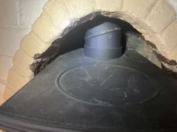

I was thinking about this one overnight. This stove has a thermostatic damper in the rear of the stove. Burying the back of the stove in the tight space of the kiva may cause it to burn incorrectly, due to overheating of the thermostat.
Well I would not say it is “Buried” Aaaand the thing is I am not getting hit burn at all and it definitely is not hot in the inside of kiva. Lots of room there. But…..
If it was running too hot the thermostat would start shutting any damper control?

Yes, the thermostat design generally works best in an open space with room air circulating around the stove. It may be closing the air off prematurely due to heat buildup at the back of the kiva.

Seems it is always shut down considering the constant slow burn and belching smoke
Suggesting that indeed the thermostat is hotter than the stove likes because the stove can not shed its heat very well back there.
A stove only running low is precisely the symptom of a thermostat tucked in a cavity.

I concur with the other opinions. The thermostat inside the firebox is probably getting hot faster than it should, leading it to shut down too much and smolder the fire.

Try adding a small blower on the floor behind the stove blowing up. I have one like this.
AC Infinity AIRBLAZE T10, Universal Fireplace Blower Fan Kit 10" with Temperature and Speed Controller, for Lennox, Hearth Glo, Majestic, Rotom https://a.co/d/ee4zeyO
Being able to see the temp on its probe and the fire and having 1-10 blower speed setting I bet you can fine tune the air flow so that the thermostat regulates the burn rate better.

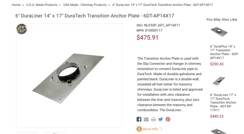

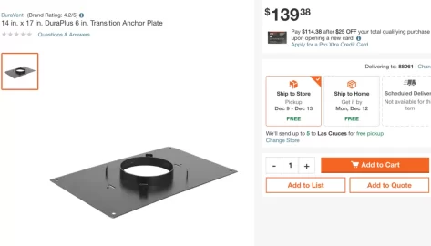

What about this estimate and part prices? Seems outrageous to add 36”!? And the differing costs in the plates?
You can get the parts feel free to do it yourself. The company you hire has to pay for overhead and employees. Overhead is surprisingly expensive.

Plus the 2 plates you posted are not the same thing. One is to go from duraliner to duratech. The other doesn't specify what it goes from but it goes to duraplus

FWIW, that's a pretty big jump in price for the 6DT-AP anchor plate. Is the 14x17 version required? The older version was a lot less expensive.

Did I ask about labor or hiring anyone? I know about overhead I have been a working surviving Artist my whole life. I am just trying to find the parts that will work at a reasonable price and I am able to do it myself.
btw. I have a piece of duravent telescoping insulated pipe I can use I thought of using that actually with the existing already installed chimney plate the top vent stack is attached to right now. I will fabricated my own beefy roof support for the extension. I am confused about why the transition plate must be insulated as well as why the stack needs to be insulated? I wish there was a total diameter on the
STOVE PIPE DT ANCHOR PLATE, 6"​
6DT-AP​
So I wish I knew if it is also too big for my 8” tile liner? Does not list total size just pipe size.

Yeah I was thinking of a way to do that. First thing when I remove the stove I am going to open the kiva cavity/Cave up to try to give it a little space. Also use a stovetop heat generated fan tht i just got. Tried it out on my old boxstove in my studio and am pretty impressed. Also will use the temp gauges I just received. As for a on stove blower I do not have much room under stove because it had to be installed without legs and only on 2-1/2" bricks for a base. This has been a BeeAtch.

This looks cool. So let me understand this correctly. It has to attach to bottom of stove and sucks in cool air and pushes warm air up and over the back of the stove? the description of how it works in the ad is vague? Can it sit freestanding under stove?

My suggestion is get a stove that you control not one that is controlled by a thermostat stuffed back inside a fireplace
