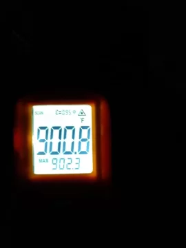

Well, I hit 900 degrees F in the cooktop center last night for a bit. It's been in the single digits - low teens at night so this has been the first decent stretch of cold weather to push the stove a little. I'm surprised since my total flue length is on the short side per the installation manual. I'm going to call my dealer when they reopen and ask what they think about the temps, mostly so I can then call HHT (VC's parent company) and tell them I talked to my dealer, and see if I have any better luck than MikeGraz and EddyB did about getting proper info for acceptable stovetop temperatures.
This was a cold start where I was able to shut the door right after lighting the kindling and the fire just kept steadily building up. It never felt scary or wildy uncontrolled, but I definitely would've have been shutting the air down sooner if it had manual controls... Plenty of flames in the firebox, and the almost solid sheet of flames from the secondary air outlets was impressive. Even after the damper fully closed I would've reduced the air more, if I could, but that could only be done by reducing the size of the primary and secondary air holes once you hit that fully closed point. Exterior singlewall stovepipe temps 18" up were 490F max and typically more like 430F.
Do the fine folks of the forum think 900F is starting to get concerning?
