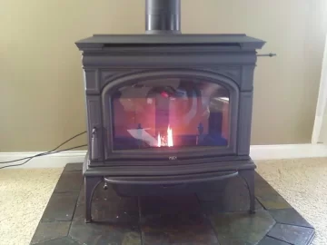

    Also, the Lopi Cape cod is gonna come in around the $3,000 range. This is a hybrid, but there is no need to remove the cat and it has all the Secondary burn tubes. It has a huge cat mounted above the baffle. This a very impressive stove. I install lots of different stoves and Vermont Castings is one of them. If you want a dependable stove with little maintenance, then I would keep looking. It might make a great stove for you, as it has for others, but it's not for everybody. Here is a Cape Cod I put in a while back.

    I live in quebec and i ordered my cape cod on monday,Lopi website
    is misleading because i also thought it was only available in the states,
    my dealer has installed 2 other cape cods this year.

    Can't wait to get my hands on the cape cod, I will
    report my findings after I break her in.

    I know that the Cape Cod has a huge cat! It's above the baffle and the tubes. It would be getting the left overs from the tubes, but I think that it could still be choked way down and use the cat to get long burns. I'm pretty sure it's the same cat that is used in the FPX 44 Elite, looks just like it anyway.
