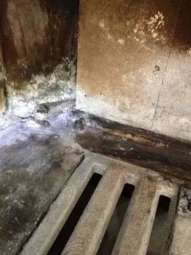

Check for cracks on the exterior and interior, especially on the floor around the ash grate.
This is what you are looking for. If no cracks and the stove hasn't been overfired, take it home with a smile.
[Hearth.com] Vermont Castings Defiant Encore cat vs Jotul 12 CB [Hearth.com] Vermont Castings Defiant Encore cat vs Jotul 12 CB [Hearth.com] Vermont Castings Defiant Encore cat vs Jotul 12 CB
Those pics look like an Olso, but the same principal applies.
Good eye! They are Oslo cracked base shots.
