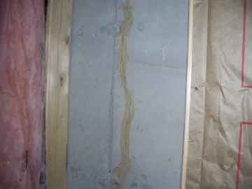

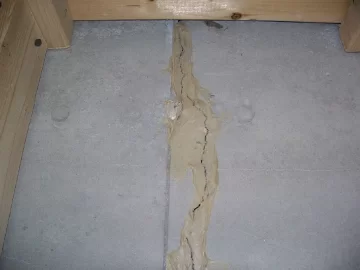

Its a poured concrete foundation wall. The crack is in the center of the wall (Foundation is 36 feet long by 24 feet wide), and wall height is appx 8 feet high.
From the looks of it, it looks like the crack started from the top and worked its way down.
Looks like the crack ran about 4 feet down when the prior owners tried to use some bathroom cauling or something, and now the crack runs from top to bottom...guessing the last 4 feet of crack is from 2005 to now.
I would say the greatest gap is about 1mm..so its not like there is light shining through....might try to take some pics later.

The gradual lengthening of a crack, if that's what happened, suggests a gradual settling or subsidence on one end of the wall or the other. But in that case, the crack should be at least a tiny bit wider at the top than at the bottom. Is that the case?
But if you're convinced that the crack has been growing, it really should be looked at by a foundations guy. Just sealing it might make no change in the end, if it keeps growing (ie. widening).
Here are a few pics, and I found a similar crack on the opposite wall:
  • [Hearth.com] Very Very Confused on Insulating a Basement

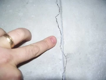

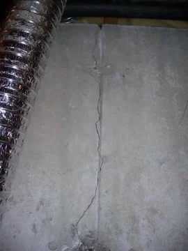

2 more on the opposite wall
If I had to guess, I'd say those are likely to be shrinkage cracks in the concrete wall that occurred after pouring. There appears to have been no displacement. These are usually not progressive, and sometimes happen naturally, though it often reflects a lack of proper reinforcement of the concrete when it was poured.
But I'd still suggest you get a REPUTABLE foundation repair company to take a look. One with references. If the cracks are due to shrinkage, they'll probably tell you it's okay to seal them and cover them.
And make sure to keep your outside foundation walls well-drained.
