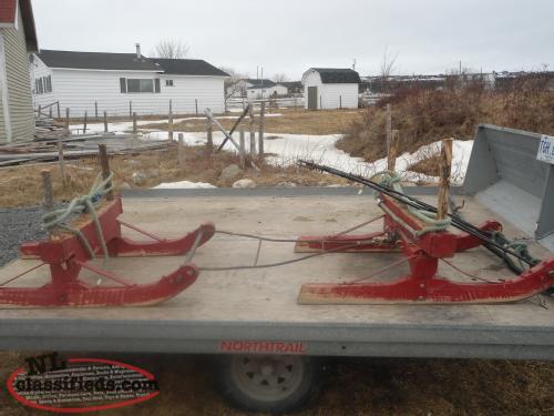

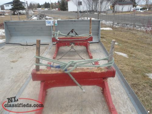

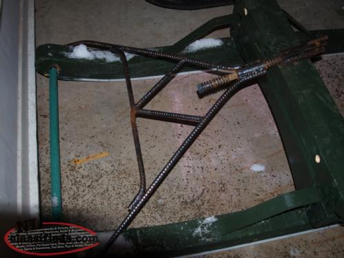

Any more pics of the middle connection point? Is the skis made of wood? Looks like wood skinned with sheet metal.
Any more information about this would be very appreciated!
Reactions: Applesister
Skis are made of rough sawn lumber usually a crotch of fur or a spruce with a natural bend. The thing with these are they are 2 separate pieces that stand alone, usually joined only by a rope or chain. Will look for more pics for you.

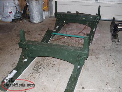

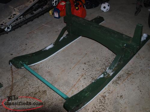

These pics show it a little better. I have never made one as I use a Labrador style Komitik. one very nique feature is that the top portion that the logs actually sit on articulate so even when the skis turn the logs sort of stay straight. Avoids the strain on the skids through a turn. Komitik is better for hauling rounds though and is a rather easy and solid build.
That's a good idea too. I tend to haul more rounds than logs, so that might be a better idea.
Made one last year, may have cost a hundred bucks. Plus the hitch, works great. Buried under 3' of snow right now or I would take a pic.

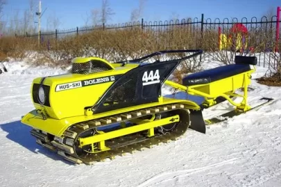

The honey badger is a ppt passé partout. It's a Canadian company that was eventually bought by a company in Michigan, where mine was made.
It's from the 1980's. powered by an 18hp onan, has a bombardier snowmobile clutch, the same transmission as an Argo, the tracks are simply made from conveyor belt, all the bogie wheels are available at tractor supply. So it's pretty simple and easy to work on.
