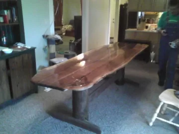

Just depends on what it is. The board on the thread 9 months air dryed and 5 months in the wood furnace room. Ends have been trimmed to take the checks out and coated with candle wax to prevent anymore checking. Did not have a MM meter so not sure where its at there but works easy enough. Depending on what your using it for is the way you would cure it...For example most live edge furniture they like all defects to show and checking or deep cracks are a bonus. I will be running some locust that will get coated with wax and sold as mantels.
One thing thats hard for a normal cabinet maker or finish carpenter in this sport is there is no real angles its all LIVE. Your just trying to keep it useful and preserved. Dad has ran his own cabinet Business for over 55 years it drives him nuts but he loves the look once its done. When I started out milling it was for him and it didnt turn out so well...lol

I know this is wrong on so many levels, but . . .
Jay, that's a nice piece of wood you've got there. ;) :)

Thanks! :coolsmile:

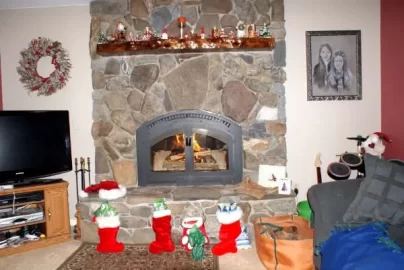

We used Walnut for our Mantel. 3.5" thick, outer edge was the bark side - we decided to strip off the bark yet leave the natural "waves" and imperfections as is after a hand sanding, stain and poly. Gotta say, it is real nice looking.
Hard to see it well from these photo's but its the best I have:

Thats Sharp! I like the bark strip as well....

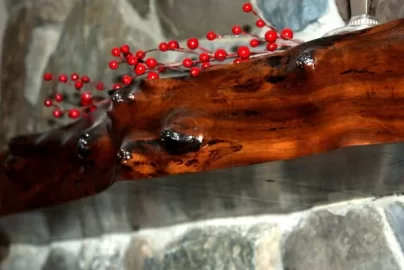

I should add that "striping" the bark off took some effort. We did in manually using all kinds of weapons to get it off w/o damaging the remaining face. I'll get the camara out and see if I can capture better angle that shows it off.

I have a couple Draw Knife's but my favorite is the one my Dad gave me its atleast 100 years old. Same design sells for well over 100.00 bucks new. Still nothing easy about it.

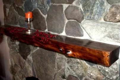

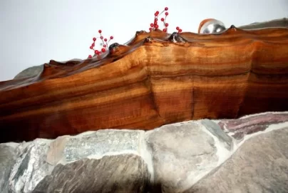

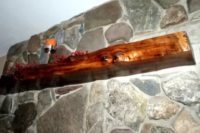

A couple different angles of the mantel

Beautiful looking hearth and insert Jay!

Thats not mine thats GOTWOOD's...He's just showing the natural edge wood. OH AND IT IS AWESOME LOOKING!
That is nutty Got Wood. Looks great against that background too.
Does it get very hot above that insert?
