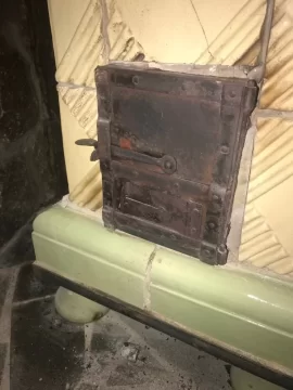

We just bought a new house and is has a rather unusual wood stove in it.
[Hearth.com] Wanting to learn about my new stove
I have reason to believe that this was built by a man from Winston Salem who worked on the Moravian stoves in Old Salem. That man has since passed away. I do not know how old the stove is. It does need some re-mortaring in a few places and even though a professional sweep has said the chimney is clear and the stove "should" be safe to use, but he has never seen anything like this so he cannot make any guarantees of its actual condition.
When we lit a small fire, smoke poured out (leading to me finding the mortar issues).
Can anyone tell me what this is, how it works and how to properly care for it? I have researched kachelofens, Scandinavian stoves,Moravian stoves, and have found very little information in English out there. Even YouTube and Google has provided next to no usable information, especially in terms of use and care.
The stove is beautiful and we really want to restore it to a usable condition, but I am a complete amateur. I have never even lived in a home that was heated by wood. Now I live in a very cool climate where the fall and winters beg for a stove like this. Any help or advice (in English) would be greatly appreciated.

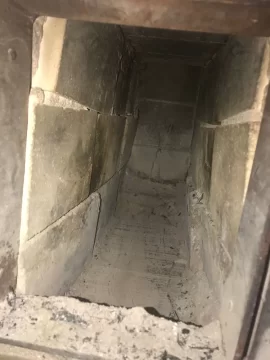

I agree, the stove is beautiful. It’s a mass stove, very common where I live. Take a look, if possible because most have small loading doors, inside the stove. If it’s a proper mass stove, you should see a “ceiling” 20 inches or so above door. If it’s a lookalike mass stove, it is empty (i.e. looks like a big empty concrete box).
It should have neither an ash grate nor any drawer to pull out ashes.

Looks like a masonry heater, can you give us some pictures at a different angle?
Well no it is just a stove. But a similar concept on a smaller scale

Looks like a miniature kachelofen, a German tile stove.

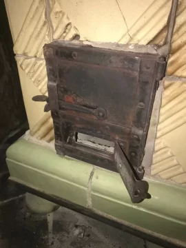

Ah, tile stove is the correct term. It is very common not only in Germany, but in all so-called Mitteleurope (Austria, Czech Republic, Slovenia etc). Yes, it’s the kind of mass stove I was referring to in my previous post. If you look closely, there should be some tiles (usually on the sides) that are not permanently “glued” with concrete, but simply with plaster of Paris so that they can be removed in order to access the smoke “labyrinth” and clean it.
The small access in the door must remain open until the flames go out, or it will crack (as it did already) or even literally explode projecting the door in the room.

Ya, you can see mortared in firebrick in that one picture. You put your wood in that little side door, the exhaust goes to the other side and up and either goes side-to-side, and/or up and down.

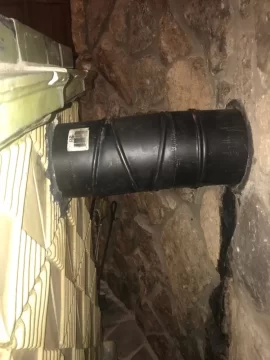

The outlet pipe is on this same side so the channel must come back to that side somehow. I bet there are little hidden ash cleanout doors somewhere on that heater. I would definitely keep that thing. As stated, there are removable tiles to get into the channels - makes sense.

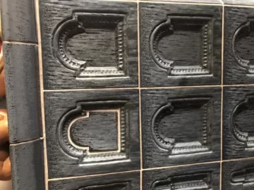

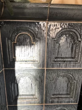

I resurrect this old thread, as I’ve been able to take a couple of pics of my FIL tile stove.
Now don’t ask me why in the world the pic has been rotated 90 deg counterclockwise... but the difference between the “normal” tiles and the removable tile is quite evident anyway. In order to clean the stove, you have to remove the plaster of Paris from around the ornamentation of the tile, brush/vacuum the smoke labirinth, and plaster it again.
There are no less than 3 of these on the whole stove.
