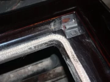

I was doing a preseason check out of the stove and discovered two cracks in the stove top. The cracks are located in the back corners of the top load door opening. The cracks are about a thumbnail in thickness, about and inch long, and they go all the way through the thickness of the stove top.

In pictures the cracks in question are circled. The other lines that appear as cracks are the "artistic" lines/cracks in the enamel coating. For some reason the picture makes the lines in the enamel appear more noticeable that they really are and I am in no way concerned about them.

I don't like it. Might not be a big deal, but this is a new stove. Have you been in touch with the dealer and Lopi about this?

Ask them to bring a monometer on there trip out and measure draft, they should have one on there truck. Im NOT making excuses for travis, they might have had a bad run of castings or something. But the situations seems like you have a great draft, maybe too good.

I'm assuming 400-600 is cruising in downdraft mode with the bypass damper closed, and you hit 700-800 with the bypass open? If that's the case it sounds pretty normal. No way a few times at those temps should result in cracks.
The top plate cracked on both sides right by the hinges that hold the weight when the top is fully opened. No mystery here. Bad casting.
