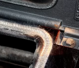

Evening up date:
We took some better pictures of the cracks and emailed them to the dealer. He forwarded the pictures to Travis.
I suspect it will be a few days before I hear anything back. As soon as I find out anything I will post it here.
So far I am happy with the dealer's response. I figure that the pictures saved them at least one trip and sped the process up by a few days.

one last pic of the underside.

I am happy to report that I had received an email from the stove dealer.
Travis Industries is sending a replacement stove top and the dealer will be out to install it.
I think this is as good as anyone could ask for. In this incident, I am going to declare that Travis passed the warranty test an it only took one phone call and one email containing the pictures posted above.
