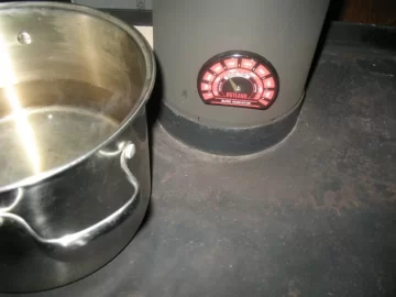

the way i understood it is water boils at 212 deg F.. well ive have my stove at 300-400 deg F for a couple hours and i still cannot get this pot of water to boil.. it just steams some from the top.. i dont understand what im doing incorrectly

I don't usually get a good boil unless my stove top is at 500 or so.
Think about your kitchen range - you don't boil water on low, you do it on high (or at least medium) heat. Same deal.
heat is transferred to the pot and I imagine a lot of the heat dissipates and can only get the metal pot so hot
Looks like your referencing your flue temp, not your stove top. Thats actually getting kinda cool from the old smoke dragon. Especially referencing so low above the flue collar. 18" up and 450-500f on single wall will give you a better stove top temp that will boil your water.

does the pot sit flat or does it wobble if you wiggle it? if its sitting flat it will make more contact (more surface area) if it wobbles only a small surface area touches so heat transfer is limited taking a higher overall temp in the stove to heat the pot enough to boil the water
it sits really flat, but is a soup pot so it has a really thick bottom, but i figured that would help! man.. im wondering now if i should even bother getting one of them stove top coffee perculators..

actually thinner bottom will heat up faster , thinner metal allows faster transfer. thicker bottom allows more even cooking due to more control of temps when cooking on a regular cook stove. dutch ovens and stock pots (the good ones) have thicker bottoms for that reason.
The evaporation is carrying the heat away--if you lidded it, it would boil. If you want to humidify, you already are.

well due to your suggestions i got it to boil!!!! hit a flue temp of 425 and put a lid on the pot and boiling away it goes! YEA! thanks allot guys!

Stove top temp. does not translate directly to boiling water. You need to figure the BTU's needed to bring that volume of water to a boil. And, you need to get those BTU's to the surface area of the bottom of the pot.
Why don't you move your meter to the stove top so you can actually measure your stove temp? The temp you are measuring it the exhaust pipe and is only somewhat related to stove top temp. For example, I can have 1000 degree flue temps and only a 200 degree stove top. To measure flue gas temp correctly that meter should be 18" above the stove so you need to so something.
