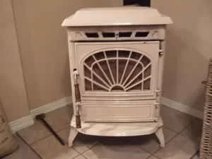

So I picked up the Waterford Erin pellet stove on Craigslist for what seems like a good deal but it's hard to tell. Searching across the internet I found a few parts available like the burn grate which was also listed as compatible with the Whitfield Renaissance. So I looked up that stove and sure enough it looks just like the Waterford Erin with some stylistic differences. However, more to the point I took a closer look at the label on my stove and found two manufacturers listed and the product name listed as "Erin/Renaissance."
Are these two items the same stove? It sure would seem that way. I've heard good things about Whitfield stoves (at least pre-Lennox) but all I've heard about Waterford is that they no longer import into the US.
Is this a decent stove or have I just purchased what may become a rather large and heavy lawn ornament once something breaks?

Unfortunately your into lawn ornament terrirtory. THat is the same as teh renaissance but since it's an older stove support from lennox is either ending or has ended. You can still probably get some parts for it from dealer stocks (Hearthtools is the man).
Thanks for the information. I have a spare auger motor and I think I'll start stockpiling other spare parts as I find them. I've seen the burn grates going on eBay for around $90 which seems steep for a simple piece of folded stainless steel. What types of things can I expect to go bad on this thing? Things that immediately spring to mind are the control board and blower motor. Are there others?
Finally, what other stoves are out there with similar styling should I find myself in need of a replacement in the coming years? My wife particularly likes the cast iron look of the Jøtul wood stoves, but wants the convenience of pellets.
Pyro (whitfield) made the guts for Waterford stove and waterford made the Castings for the cast Whitfield stoves in the early 90's
there are NO more parts available for that stove other than limit switches, Auger motors, Burn pots, U TUBE removal kits and Convection blowers.
All the other Stuff that you WILL need like the booster blower and control board, Auger Assymbly are NO MORE.

So what types of maintenance might I do to prolong the life of these no longer available parts? Do those parts just fail or will they announce their impending demise? If I can get another stove cheap for parts would you advise it or should I begin saving for a replacement for the inevitable? In the case of the latter, can you give me an idea of similar stoves (i.e. porcelain on cast) that are of a more recent vintage?

I would not waste my time with that stove unless it was fully functional now
it is not a big heater and is Picky on pellet fuel and need to be kept real clean to run well.
