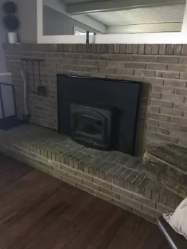

Exterior chimney on the North side of the home. Split level home and he insert/fireplace is below grade by 4-5 feet so the actual firebox is 4-5 below grade as well. Photo attached if that helps. From where the photo is taken, I am below ground level if that makes any sense. The windows in said room start at chest level.
I do not have a block plate (which I did some reading about this morning). I assume that in conjunction with insulating, the block plate is needed as well.
