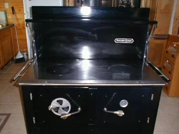

I have noticed sometimes that when I heat our stove up really hot for the fist burn in the morning there is a weird smell outside. I go out feed livestock and it kind of smells like snakes, you know those little black things kids burn for 4th of July. I just swept the chimney the 1st of December and got pretty much nothing out of it. We are burning dry wood and burning hot fires once a day. Stove is a Kitchen Queen 480 cookstove. Anyone have this before? Anything to worry about? Thanks

This is not a cat, or secondary burn stove folks. It gets air through the door admitted to bottom of fire on a grate as well as to the top through hollow door.
We burn a Kitchen Queen 480 as our only heat source as well.
They always circulate a certain amount around the oven, so maybe you're smelling that burn off after an overnight burn? Do you keep the oven door open for more heat all night? I find that cools it extracting more heat and needs more frequent cleaning around oven circulating passage.
Is the smell only with the bypass open? That really increases heat to the outlet box and pipe.

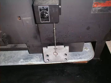

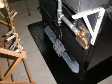

I added a thermostat on the back and open it in the morning that lights most anything we put on the coals instantly. Very little smoke and no strange smell.
