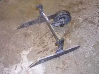

I have the tombstone 220v ac/dc lincoln. I end up welding together hitchs for tractor attachments or deck cracks...stuff like that. I think a log holder tray for the speeco will come soon. My neighbor has a 140 or so lincoln wire welder w/o gas. It does not weld anything thicker then say an eigth of an inch. He may have power issues in the garage cause it trips the breaker so it may not be a true representation of the units ability. I can wholeheartedly vouch for the lincoln stick welder though. I did not know how to weld 4-5 months ago, now everything holds together. I get better each time I use it. Wire is supposed to be easier though. Whichever you do, see if you can get someone who knows what they are doing to help you a time or 2. I had problems till a buddy came over and then the light came on so to speak. If you go wire I would push for a 220 welder or if money is the issue go stick, but thats my limited experience...here is my last project...
