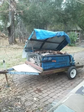

I agree. You guys that live in the snowy north have issues with precip. One option is a covered trailer. You have to watch the weather and have something to move it around, but is is very convenient. I keep a cord covered at a time and pull from it to load the trailer.

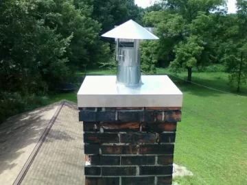

I believe it's an 18 gauge liner, 304 stainless steel. I understand it's not listed, but it's safer than what was there. We don't have inspectors here. I contacted the local fd and local sweeps (45 minutes away) and they said it would be okay. The liner had a double roll lock system, it was assembled, numbered, and predrilled for stainless rivets. It's the same thing Elmers in Maine sells for a fraction of the price. I watched them hand craft liners, 90% of the amish use them as well as many locals. It's been 5 years or so now, and the liner looks new. I also used the amish for a 2 story addition and they charged 1200 dollars for labor. I've learned they pride their work and do an excellent job. They make an honest living, unlike most of the local contractors around here. Here is a picture of the top of the chimney.

That should be ok but you cant stand on 18 gauge pipe on its side it will flatten easily. But it should be a good liner as long as the joint is good and yes
Well I'm 125 pounds, so I'm not a big guy. The local amish get 20 years out of the liners, but they burn coal and 304 isn't rated for coal. It came down to the safety of our family and performance, which the old masonry chimney had cracked tiles from two previous chimney fires my father had. The chimney is 32' tall on the side of an old victorian home. I'll tell you without the safety line and overhead clamps, I wouldn't have been able to install it. That thing had some serious weight to it. I had the option to install a thin wall flex liner, and I choose this route.
I am sure it is much safer and i dont fault you for going that rout at all but as a pro i would never install one like it or recommend that someone does But we also do not install light wall for wood stoves either. Did you at least insulate it? And yeah the factory made rigid liners are the same way they are a real pain to install thats why we hardly ever do them
Yes, the liner is insulated. We produce only a few cups of creosote per season, but I sweep our chimney once a month to every other month for safety. We used to remove half to 3/4 of a 5 gallon bucket per sweep with the old furnace. I did a very through sweep before the install. Not to sound bad, but around here the pros at alot of things are terrible. I've seen too many thing that were shortcuts and dangerous. Personally, I trust very few and the reason I choose to install myself. Same goes with carpentry work. The amish did our framing and sheathing, I did everything
