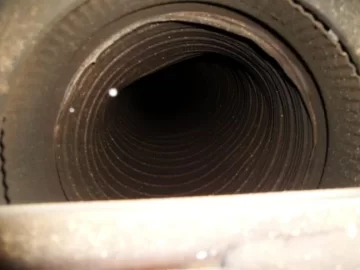

I have wood that has cured, split and stacked, for two years but I did not keep it covered. Can I rotate the wood into the house and get it try enough? What about using ACS as I burn…will that keep creosote from forming?
Here’s a pic of the chimney after two weeks of burning (inside stove):
  • [Hearth.com] wet wood

Not sure whether you intended this or not, but water-wet wood is not what causes creosote formation in your chimney. If your wood has been split and stacked for two years, you won't have much of a creosote problem if your set-up is good, and surface moisture on the wood won't increase whatever creosote you get from burning it.
