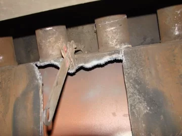

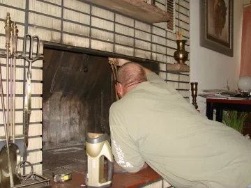

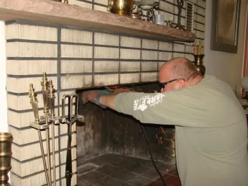

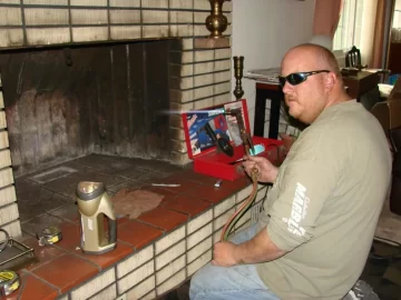

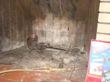

I spent the better part of the day removing my fireplace damper, back of firebox and smoke shelf.
I started with a 4.5" angle grinder with a cutting wheel, and a sawzall. After an hour of screwing around
i went to my Dads shop and got the torch. I wish i would have started with the torch in the first place.
I dont know about anyone else's experience with this, but man! I cant be contorted like that for any period
of time. I guess 10 years ago i could have done it no problem. Anyways, i got it done thanks to you guys.
I was going to have it installed but after a $1600 quote i started poking around here. It was a groan but
i am glad i did it myself.

I did everything but the torch. Then I went and got the hacksaw and shortly I was done. You would not believe how easy a hacksaw cuts through that stuff.

I started with the bottom half and found the firebox to be about 1/8" steel.
It cut pretty well with the sawzall. For some reason i was thinking the damper
would be thicker steel. Like maybe 1/4" . Actually it was only 10 gauge or so.
My biggest problem was just holding the saw or torch up and out for any length of time.
The wife thought i lost it when i ran the torch lines through the window.
Thanks again for your help on this.
Brad
Oh come on, in that second pic you look like you're having a lot of fun!! I'm guessing the wife wasn't home. :cheese: OK, maybe it wasn't all fun, but you did get'er done. Nice Job!
