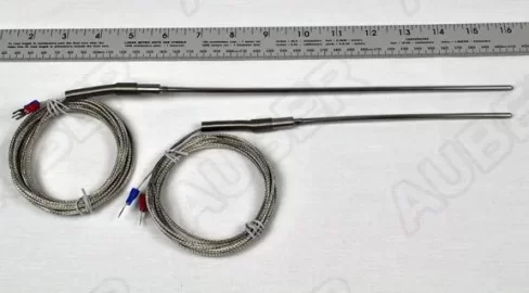

What thermocouple are you using and where are you putting it?
It is the K type, Auber's WRNK-191
