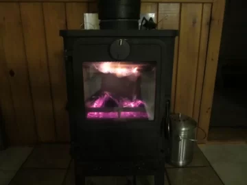

Just for fun, stove at 650f

Yeah ok...your fire is definitely different than ours. Way more coals and secondary combustion. I wonder if my husband is running ours more like an open fireplace...that's what he's used to. But then it can be hard to identify secondary combustion in our stove because the eco brick is so "tall" on its own that its flames show up at the top of the box anyway.
