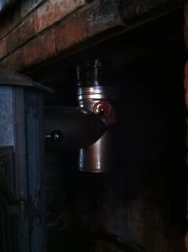

My stovetop therm usually reads 400 - 650 or so when the stove is lit and cat engaged. I have the therm placed above the cat, which is in a cast iron hood that probably gives a good bit of heat in and of itself.
On the flue pipe, I have a short tee, non-magnetic, so DH and I attached a therm with thin wire. That therm never gets above 200, even with the stovetop at 600+ 12 inches away.
What am I doing wrong?
Thanks!
Mary

Nothing. What did you expect it to read? First off, a proper probe meter would read about double, or 400 degrees for the temp of the exhaust. Your temps are what I would expect on the backside of a properly functioning cat.
You should be able to briefly hold your hand on a 200 degree surface. Try your fingertip first. If you're particularly weak, lick your finger tip before touching the 200 degree surface.

Nope, it sticks at 200 no matter what. FWIW, it's new, and when I started it out, it sat on the stovetop along with the other. Its readings were consistently 100 degrees lower than the older one that came with the stove...but now it just hangs at 200 no matter what the stovetop temp.
The pipe is hot to touch, that's why DH used wire rather than trying to steady and drill into it.

Well, it has these "zones" marked on it that say under 300 is like "Danger, Creosote" or some such thing. So I was afraid I was mucking up my brand new liner and tee - but it didn't seem right since the stovetop temps are good and the stove is kicking out good heat, with decently long burns and most wood is burning right down to nothing, with a nice coal bed for each new load.
If the interior is twice that, then I'd feel better. :)

Well, I dunno - it's had SOME fire since we installed it a week ago...but even in the AM with stovetop = 250-300, pipe reads 200 (or a hair lower), then later stovetop = 600, pipe still reads 200 ish. It does seem to work on the stovetop, but it's not behaving on the pipe.
Well I dont think its working, should be hotter than that when you have the cat bypassed.
Take the wire off and use a screw through the hole in the middle of the thermometer. Maybe the wire is keeping the back surface of the thermometer from sitting flush against the pipe? I also wonder if that wire was catching the spring wound indicator when it heats up and could of broke it?
Considering your stove top temps sound perfect, I wouldn't worry about the flue temps if it were me. W/ those average temps, I'd say you must be burning well no matter what that thermometer says or "thinks."

Those zones are pretty approximate and pretty much not applicable to a cat stove.

Mary, I agree with Todd that the wire might be part of the problem. You did not state where you purchased the thermometer so we are blind on that one. But just to let you know what can happen, as you know, Woodstock includes a stove thermometer with the stove purchase. We had never used one before but I got to liking it so wanted another one. We even received one as a gift. But there was a difference!
Woodstock gets their thermometers from Condar. Rutland is the most common that we find around here and we ended up with two of those. They were a big difference from what the Woodstock thermometer read. We purchased another one from Woodstock and it was only 10 degrees difference at most from the first one. We had checked the first one in the oven and found it to be close. Later we purchased an IR thermometer and it confirmed what we had. The Condar were pretty darned close to the IR. The Rutland were a long ways off. We put those in the trash.
As for a difference in temperatures between the stove top and flue, yes, there will be a big difference. The flue simply will be at a lower temperature except when you reload and before you engage the cat. With the flue thermometer, we tend to get it to 400-500 and the stove top to 350-300 before engaging the cat and that seems to have worked the best for us.
Is there any chance (it is hard to tell from the pic) that you have the thermometer on a stainless steel insulated chimney tee? The exterior of those will never get over 200F.
Test in a 350 degree oven then you shoud know if its working.

Dennis, it came from the stove store where I got the Harman XXV - was there getting pellets and showed an interest in a new therm so they gave it to me for free. It's a "ChimGuard". The one that came with the stove is probably the original one from Woodstock as the seller gave me everything he had, records, manuals, etc.
unhdsm, yes it's on the tee. It's either that or the liner cause that's all I can reach (and I can barely reach the edge of the liner.
estang, I know it works cause I had it on the stovetop for the first few days with the other therm. It read cooler but it did work.

I was less concerned that it was on the tee as I am making sure the tee is not Class A and insulated. In that case, I would not expect surface temps to be hot at all.
I have an almost identical setup to yours, rear-vented to stainless tee to flex liner. I have a surface thermo lying on the tee snout directly behind the flue collar. It might register 400-500 when starting a load with the bypass open. After it's up to temp, the bypass closed and cat engaged, stove top will go up to about 450, temp on the pipe is around 350. So 200 where you have the thermo (further away) might be about right. The flue thermo is useful on startup/reload to make sure you're bringing the stove up to temp in a controlled fashion and not stressing your chimney or stove by firing too hot. The stove top temp is going to lag behind what is actually going on in the firebox, so the flue thermo will give you a more accurate picture early in the burn. Next time the stove goes cold you might want to screw that thermo to the pipe. Stainless is hard to drill though, and the drill bit has to be the right size or you'll have trouble getting the screw to thread in...

Yes, the stainless T outside temp will not show any thing much hotter.
I bought the Condar probe and drilled the hole in the T in same place you have yours. Because it is stainless, I had to make a bracket and screwed bracket to ss t and then the probe sticks to bracket. My probe will show 1000 degrees and the outside of T with IR gun shows 200. After I engage the CAT, the probe will run around 400 - 900 depending on the air control.
