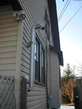

Mine was put in by Harman Installer..
  • [Hearth.com] What do you guys use for an OAK?
