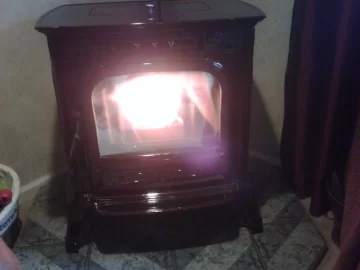

I tried sifting for about half a season... and then I came to my senses. There was no difference in heat or performance when I did, so I just let the stove do it's thing.
Plus, you get some nice sparks when the sawdust lights up!
My " fines sifter "

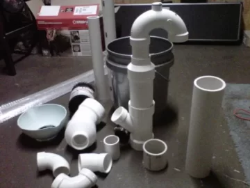

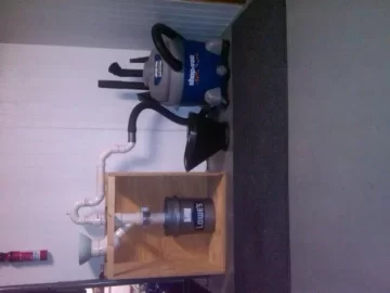

Well thanks to imacman. I finally got my sifter up and running. (I know some disagree) But I have to clean the hopper about once a month due to a Fines build up. Besides the $25 it took to build it, I dropped and broke my phone 2 days ago, while trying to take a pic of the progress. So add $50 for ins replacement also. LOL still worth it
  • [Hearth.com] What do you use to sift out fines from your pellets?
Oops. Wrong pic.

One persons trash is another persons treasure. Does not take as long to build device as one would think. Also does not take long to "sift" the pellets. It sits right outside the pellet crib in the basement, so its on the way. Cuts the dust down 100% (6.5 hp gets it done w/ hepa filter& fine filttration bag) Anyone who owns a pellet stove knows the dust that comes along with one, is astronomical! So to each there own, but the Quads spring style auger (not solid) lets all the fines stay at the bottom of the hoppper. A screw and cylinder set-up would prob eat them for seasons on end without a problem. For the time it takes me now to "sift" the pellets for a months worth, would be the same time spent cleaning the inside of the hopper once a month. And to fully clean the bottom, I have to suck the fines and some pellets out with vacuum. So the conclusion.... Well.. I like it and I am no longer throwing pellets away. I will still clean the hoppper. But now only once a year. (end of season)
Honestly you guys are right....most stoves will burn the fines without a problem. But before I built my pellet vac, like Mac has, no matter how slow I poured a bag in my quad..the living room would get dusty. It still does but vacuuming them has definatly helped....I know..I clean. It took 1 hour and 20$ to make and I can vac a bag in 90 seconds....(give or take a second or 2). AND when Im trying to get rid of shoulder season pellets. I dump in at the same time with good pellets and it blends them up nice!! Yes I might have to much time on my hands but at least its not being used on cleaning the livingroom. Besides...there is a beer fridge beside the pellet vac :>)

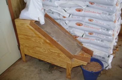

Hello
I found some scrap wood and made the "TRH Wood Pellet Fines Sifter"
It fits right over a metal trash barrel and you just dump a bag in. After the sawdust is sifted into the barrel, the sifter is tilted so the end that the red arrows point are into the pellet bag!!
Just fine window screen at Home Depot and scrap wood!
See pic below:
That's the one for me!!!
Simple, and low tech.
The only down side I can see is I can see me chasing some pellets that fall on the floor.
It actually works well, the fines fall into a regular metal trash can and then you just tilt it and pour out the pellets!
Works for me.
