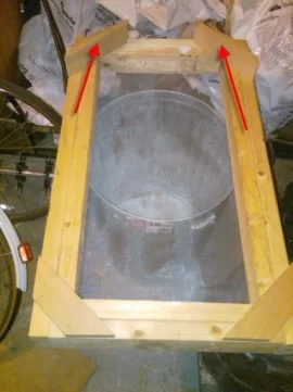

    I found some scrap wood and made the "TRH Wood Pellet Fines Sifter"
    It fits right over a metal trash barrel and you just dump a bag in. After the sawdust is sifted into the barrel, the sifter is tilted so the end that the red arrows point are into the pellet bag!!
    Just fine window screen at Home Depot and scrap wood!
    See pic below:

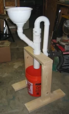

  9. Kenny1

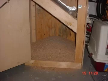

    I use to use this now i burn everything
