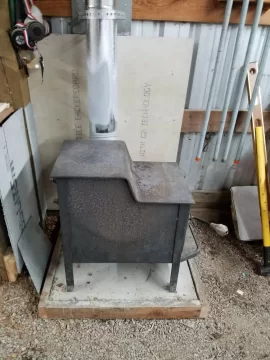

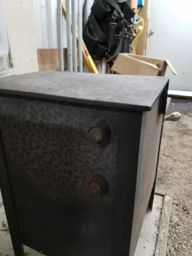

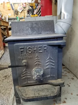

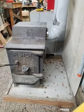

Was given a wonderful Fisher wood stove and was trying to ID it . It is a baby bear , side vent , with connectors for what I believe is a hot water system .

Is that how you currently have it installed?
Galvanized duct pipe is not appropriate for stove pipe. Read up about zinc fumes. As it goes up, the clearances are not right either. Single wall stove pipe needs to be 18" from any combustible. What is the chimney connection? Also, the stove needs 36" from combustibles. Makes me wonder how many other issues exist here.
As in the photo , yes .
Ok then i see a few problems.
Clearance required from that stove is 36" you can reduce that to 12" with a proper ventilated heat sheild which you dont have.
Your pipe needs 18" can go down to 6" properly sheilded.
Your pipe is upside down and shouldnt be galvanized
Got
Got the black 24 ga. And will install in correct direction . Moving away from wall and putting up concrete board with air space .
