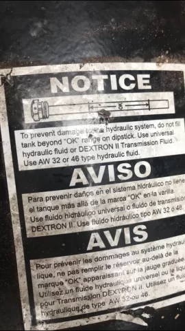

I had a leak from filter of my splitter and now my fluid is on borderline low. Seem clear and ok. I started to do research and got overwhelmed with options and opinions. There is a label on splitter you can see below.

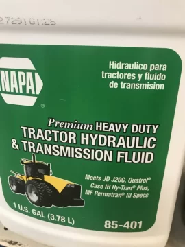

Is this one good? https://www.napaonline.com/en/p/FCT85401

For a splitter you can use pretty much any oil,it is a very basic system.
Use ATF or Hydraulic oil.even power steering oil is similar.
I mix various oils in the hydraulic systems of heavy equipment for various reasons,mostly i use AW32 mixed with ATF for the red color.Makes it easier to see in a sandblasted site-glass.
For my splitter i run it on synthetic ATF,it sits outside till i need it. I can start it at -20C without ant trouble with the synthetic ATF.

Many people overthink Hydraulic fluid. As salecker said it does a very basic job of moving objects in the system, not so much lubricating things as in a motor. Most any basic Hyd. oil will be fine.

I use Dextron 2 in mine it is what is recommend
and does not cost an arm and a leg
Like the others said it's very basic for use in a splitter. You're not protecting a sensitive multi thousand dollar hydro system.
AW32 would be a common hydro juice for your splitter. The stuff you are looking at is a multi viscosity, but you won’t hurt anything by using it. Especially if you are just topping it off.
The big thing to watch for in hydro juice is compatibility. You don’t want to put anything in it that won’t play nice with what is already there. This is NOT the issue with the stuff you are looking at, just pointing out potential pitfalls of mixing fluids.
The NAPA oil you have there will do just fine...

My 27T Troy Built Manual says approved fluids are Dextron III/Mercon ATF, or a 10 Weight AW Hydraulic Oil.
