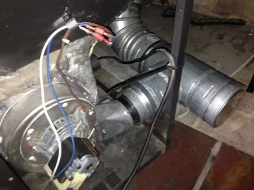

The 4" diameter flex line goes to a reducer into the stove. The stove flange is too low to the floor to just put a cleanout T on it. Can anyone suggest a good way to do this? see pic below.

First off when speaking about reducers...they do not exist in venting. You can only INCREASE...a technicality... so they are called increasers. That design there by Breckwell is flawed. They offer the same stove with a pedestal, but in the insert...they just leave it the way it is. Sometimes you can kick a 3" T on there at a 45. Or it you are really ambitious, cut up a T and make a short body T...I usually do that with a single wall liner T.

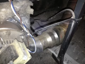

Well, I found a fix
A stove adapter combo increaser to 4" diam duravent venting to a 4" diameter cleanout T to a 90 Deg elbow to a new 4" flex adapter. Had to cut the flex liner back a bit. Wow it was a harder SS liner to cut! Must be good stuff!
Also the stove's exhast flange was very loose. Therefore I had to remove the exhaust blower with the exhaust blower housing and remove the flange and clean out the old RTV and put in new! It is never a simple job!

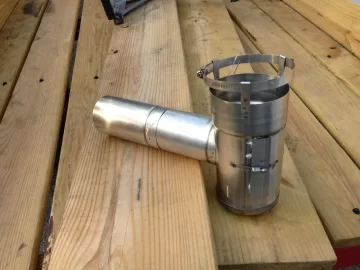

Thread for me thinking that this is something I wanted to make up. Had Olympia make me this. Shallow t with flea out opening on the back. Snout can be cut to suit desired depth.
On the P22i there is only 1/2" from the stove flange to the bottom, so that would still have to be turned sideways. Even if it did fit, you would not be able to get the cleaning cap off. Right?
It fits perfect. Clean out is on the back.
What is the distances in inches between the bottom of the T and the bottom of the pipe that goes into the stove?
