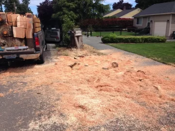

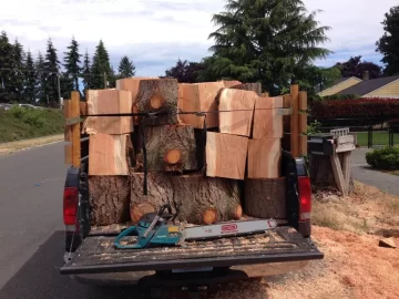

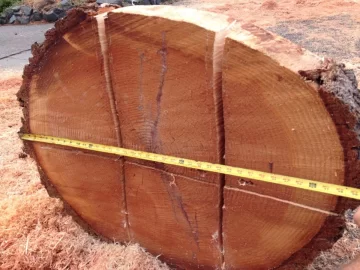

Hard to understand your question in relation to the problem. To increase speed, only split to liftable size and then move them. That's the goal, to move them. I pick up lots of wood from tree services at the customer's house and these are big rounds, like 36"+, and I need to move them fast before somebody else gets them and as a service to the homeowner.
I don't split them, I take my saw and quickly cut them into chunks small enough to lift into my pickup. When you get to some actual large wood, it is hard to even move them to the splitter.
