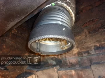

I was able to get enough down-angle to the stove top with a 15* elbow.

I installed a free standing with flu going through the fireplace. Had to install a 90 elbow on top of stove because I wanted the stove sitting outside the fireplace. The 90 is angled about 75 degrees. The insulated flex liner makes a nice sweeping bend to create the vertical run up the chimney. Total height is 16' and this thing drafts great. Never, I repeat, never any smoke in the house and at times less draft maybe better. And this is in an area with very moderate winter outdoor temps of 30-40 night and 50-60 day. ymmv
