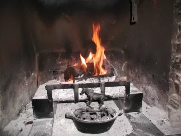

Can anyone tell me anything about our firebox? We are in the planning stages of installing a hearth mounted wood stove and I just want to make sure there are no problems keeping this type of firebox when the wood stove is installed. The firebox is metal, the floor is brick. That is a blower grate you are seeing. Yes, it's messy in there tonight!
Note: There were glass doors on this fireplace which were removed this heating season. We do burn the fp with a screen but I removed it for the picture.

Looks like a heatform firebox to me.
Probably nothing wrong with using it as long as the steel
walls are still in good shape...
If you plan to leave it exposed after your woodstove install,
you might wanna paint it with hi-temp StoveBrite black paint...
It'll be a better looking set-up...
Agreed, looks like a heatform.
Are there a couple square vents on the wall to each side of it? Most heatforms I ever seen had the circulation vents, mine does also.

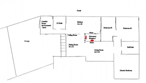

Our fireplace opens to the living room and is stone on three sides, the backside being the kitchen. The vents you are speaking of are on the narrow end of the fireplace (the red rectangle in the attached photo). With a fire going in the fireplace with the fan vented grate we added a small fan blowing into the bottom circulation vent on the narrow end of the fireplace. We can really move some heated area around.
