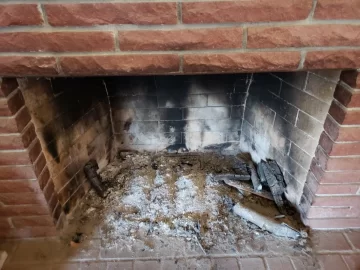

Well you guys don't have a stove pipe only area. This is where to post I think? So here's what I think needs to be done? 4" stainless steel exhaust pipe my run to the top is 13'-16' I have not measured it yet then I want to run the OAK all the way to the top also and that's a 2" aluminum pipe I'm guessing? Also for the termination at the top what do I use for both pipes? Just want to order pipe and get ready for install this spring. Thanks for your help Jeff

What kind of fireplace are you installing it in? For the exhaust you can buy 4 inch liner kits that include the T connector and a plate and cap connector for the top.
Just a regular brick fireplace. I wanted to run an OAK all they way to the top so I have no issues. yes I will clean the fireplace out and put granite on the brick.Thanks Jeff
