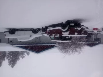

No Pellet Delivery here in Bulk. They only deliver wrapped 1 Tons packages. Last year it was 90 bucks. Won't deliver in SNOW. This year since we have 2 tons sitting will only order if we run low. Typically use 3 tons. Hopefully Heat Pump can pickup the slack (One that works down to -20f). If not we have Pickups. Use Tractor to get from PU to house. Sorry about pic upside down. Even when I turn it it still shows upside down. Strange.

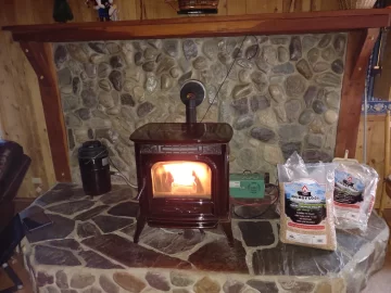

This Winter Season will be interesting to see how much Heat Pump does vs Pellet Stove. Unknown, old Heat Pump we quit using at 30f. This one I will run until -10f if Numbers Show it's not too much of Elec Hog. Kw here is .006 so it's pretty cheap.
