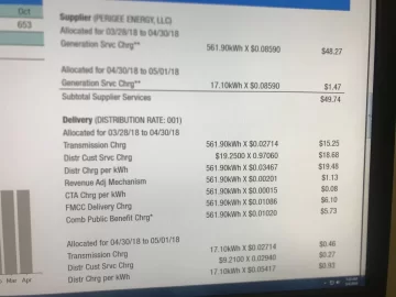

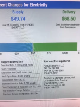

Tried to look at my bill and now more confused . Can you take a look ?
You pay about 16.7c per kw/hr. You have two parts of your bill supply and delivery. You didnt add the delivery cost in which is 562/68.5.
