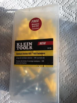

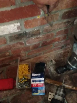

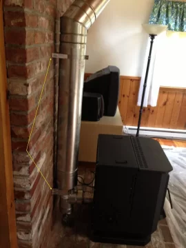

I always like to improve and find tools or materials that work better. Therefore, I tried the Tapcon but went back to the old yella. (Klein conical fasteners)
What works best for you?
See yellow arrows in pics below:

I likey Tapcons.
But they're not very aesthetically pleasing.
Don, please tell me you're not mounting brackets to interior venting as in that picture....? Errrr. I hate those type of pellet in to class A installations...what do you have there...3" in to 4" in to 6"? Can't make em look good. Any type of plastic anchor like you are using is fine...its just holding up some pipe,. not trying to support a bridge. Tapcons work well on brick...but not in mortar.
Scott, I belive that is Selkirk DT that he has mounted there. Not Class A. Selkirk starts at 3" on stove (adapter), then into a 4" T, then the 4"/6" DT pipe.
That's right Dexter and it does need good support. I rather support it well and be safe!
