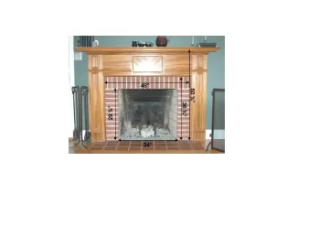

Hello. I have wavered quite a bit on what to do with the fireplace in the front part of my house, but now feel fairly certain I want to go with an insert and would really appreciate input on what type I should choose. I'm looking to heat the front part of my home (approximately 600 square feet and open), as well as get at least some of the heat to the upstairs (which is another approximately 600 square feet) where the kids' bedrooms are. I have a Hearthstone Homestead in a freestanding setup in the back of the house; however, I don't get any of its heat in the front part. I have included a photo of my fireplace and mantle, including measurements. (I didn't include this in the photo, but the depth of my fireplace is 18 3/8" and the width along the back wall is 26 1/2".) I'm not going to get rid of my mantle (soon to be painted white), which I know somewhat limits me on insert choices. I know this sounds picky, but I don't want a stove with any gold color on it. Obviously, a blower is a requirement. In addition, I want a stove with glass in the front to allow for the joy of fire viewing. I do plan to have a full liner installed in the chimney. Is there an insert out there that will meet my needs? Thanks!

I did not see if you listed the height of the mantle. Couple of measurements would come in handy. Floor to bottom of where the woodwork starts. Floor to bottom of shelf. Thickness of lower "trim" from the brick and the also the depth of the shelf from the brick.
If the mantle heights check out these two inserts would work. You could go bigger as well but it sounds like you don't need that much heat. Depends on how well insulated the house is as well, a poorly insulated house would need a larger insert.

Thanks for the feedback. The height from the floor to the bottom of the mantle is 50 1/4". It's 36 1/4" fom the floor to the bottom of the woodwork. It's 29 1/2" from the floor to the bottom of the shelf (assuming you mean the front opening of the fireplace cavity; otherwise, I'm not sure what you mean by "shelf.") The lower trim is 1 5/8" thick.
I checked out the Quadra-Fire 2700i, as well as the 3100, and definitely think the 2700i best suits my needs. The only clearance that doesn't work is from the top of the stove to the lowest part of the woodwork; however, I believe this can be taken care of if I fabricate a heat deflector to install at the top of the panel. Am I right about this?

I just looked at your picture full size and I see you had the measurements on there already, sorry for asking a silly question. After looking at the manuals the 2700i does not have any provisions for using a mantel deflector, and also specifies "trim" must be 3/4" or less. Often times you can consider the lower section of the woodwork as "trim" and take the "mantle" measurement from the wood shelf that sticks out. With your setup the lower part of woodwork would have to be considered mantel when taking measurements for the 2700i. So if you want to go by the manual it would be out.
The 3100i does however have reduced clearances with various mantle shields and deflectors. Also the 3100i does not specify any thicknesses for the "trim" measurements.
You may be able to reduce clearances on the 2700i with a mantle shield but its not documented in the manual. Someone (your dealer of choice) would have to call Quad technical to find out if there are any mantle shield options available that are not printed in the manual.

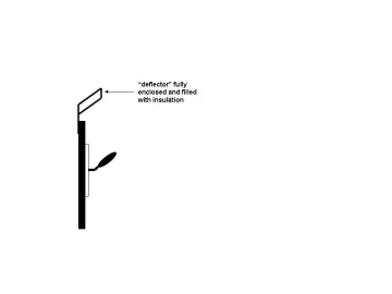

Thanks for the feedback, everyone. I researched ALL of the suggested inserts -- and then some. I still cannot find an insert that definitely works, particularly regarding clearance to combustibles. The best bet still seems to be the Quadra-Fire 2700i. If I consider the lowest portion of my trim as the mantle (due to its profile), the top of the 2700i will be about 7" too close. I wonder if a heat deflector that would allow me to meet code is available as an option with the 2700i. If I build my own heat deflector, it's going to be more than just a simple piece of metal designed to deflect the heat (see design below). I would attach the deflector, which would protrude 4", to the surround panel, running it the entire length across the top of the panel. I can't imaging this would leave me with a stove installation that fails to meet code. I certainly want to be safe, as I value my home and life, as well as the well-being of my wife and children. I just wish there were an insert that fits my fireplace AND allows me to meet clearance-to-combustibles requirements. Is there?
  • [Hearth.com] what type of insert would you choose?
I think if you look at the 3100i and you used the 8" deflector and the mantel shield it would just barly make it. Double check but thats what I figured the other day.
You're right, the 3100i does appear to work with the 8" deflector and mantel shield. (I didn't see a mantel shield listed as an option; is this something that you have to fabricate yourself?) The manual is not clear on measuring to side trim; is the measurement taken from the side of the "stove" portion of the insert (at 27 7/16"), or the side of the grilles/screens (at 38 7/8)? Also, there is nothing in the 3100i manual that indicates the maximum depth of the side trim; should I assume it's the same as what's listed in the 2700i manual (3 1/2" maximum depth of side trim)? Finally, Is the hearth extension measurement taken from the front of the glass, or from from the front of the fireplace? Thanks!
