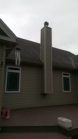

Have a pic of the outside and re-measured It is actually 14' from the tee up to the top. So starting over ....off the top of the stove up 24" hit a 90 then horizontal pitched up 36" to a "T" then 14' vertical as you can see by the pic

Well it is a good looking layout, too bad it doesn't work well. You know, you can cut in a box in those trusses and make that pipe go straight up. I know you have a lot of time and cost in that chimney, but if extending the pipe doesn't fix it I don't know what else to do.
I agree, your setup looks very nice.

I think I have read on here that each 90 reduces the effective chimney height by 3 feet. This would put you at around 10 feet. The Oslo needs a minimum of 15 feet of chimney. Hope you can work it out since it is a nice looking stove and hearth setup.

I think two 45s might help but no guarantee there. Most stove makers want 3' straight up before any turns, and you said you've got only 2' there. As was mentioned I'd also try putting a temporary section of cheap pipe on top to see if that helps. Looks like it's on the back of the house, so may not even be noticeable. Also, where is the prevailing wind coming from...over the main ridge? Do you notice any difference when it's windy, versus calm? The Oslo wants more draft than some other stoves to run well, pretty good chance that is where your problem lies.
