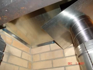

Is this an external chimney? did they put a block off plate at the damper below the insulation or did they just stick some insulation around the liner? Is it an insulated liner? With no block off plate and just insulation some (if not alot) of your heat is going to heat your chimney and the great outdoors.
also add to above ---and how well is your house insulated?
How well would a log home with no drywall and all WOOD be insulated? No its not an insulated liner as they didn't say I needed one and put in the liner they quoted me with. I brought up this block off plate to the dealer and he said they put a plate up at the top before the chimney cap.

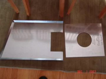

a block off plate goes right where your damper was...
here is a pic of mine
the top of the block off plate should be insulated as well and if do not have one that is a huge heat loss i have a block off plate and a plate at the top of the flue

Shipper50 said:
iceman said:
Putting a cap at the top keeps rain and rodents out, but does nothing to stop heat transfer from the stove to the masonry. That is what an insulated block off plate does. Read up in the Hearth wikis about block-off plates and sealing the damper area.
Also, you may get more heat out of the stove by closing the air down about 50% after you have a good fire going. By doing this, you encourage strong secondary combustion and are not cooling the fire down so much with an over-abundance of primary air. Put a stove thermometer on the face of the stove to the top right or left of the door. It will be a helpful guide on how the stove is burning.

I suggest a block off plate regardless of what anyone says. Very least, it is safer and helps keep heat in instead of up. That insulation ain't gonna do much.
