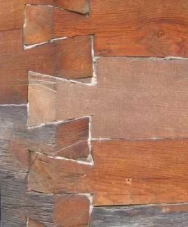

Most modern log systems I've seen they try address infiltration pretty well. Usually there is a deep rabbit cut that receives a thick thermal chinking block of felt or other material where the log surfaces meet. That covers shrinkage and expansion pretty well. But even an old log home can be nicely chinked. If done right it works well.
Here's a shot of a church from the 1600s we saw in the Ukraine. That is the original horse hair chinking there.
My house is very close to this as it has dovetails and permachinking? Pretty sure they did away with the horsehair when this house was built in 1998 from what I was told.
Shipper
:lol: LOL :lol: yes, I suspected they would use a more contemporary material.
