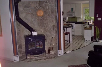

Here's how my current stove is situated. It's kind of dark, but you get the idea.. Extending the hearth kind of puts it in the traffic pattern.

That odd the pic shows up on my PC. It's posted on a BuickV8 forum. Let's see if this will work. Before, I couldn't find any way to upload to this site.

That works great. I lightened up the pic a little. That is a beautiful spot and the home looks really nice too. But the bad news is that appears to be a really illegal installation. Is that single wall pipe? If yes, the flue pipe clearances look way out of the safety zone.
