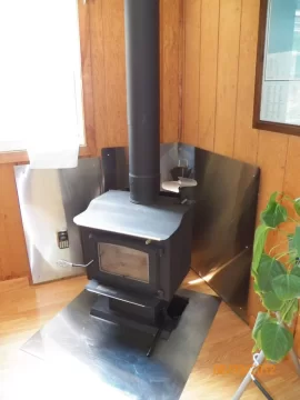

Put up metal wall with spacers that I can hold hand on now, I sleep better now also.
90º over ambient is the threshold and it sounds like you are at or close to it. Concerns could be alleviated with shielding at the wall or perhaps at the flue connector.
Took me 1 hour. One inch space. Curtain has been removed.
