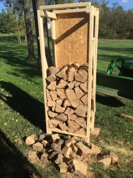

We finally had a new insert installed into our Heatilator prefab. Needless to say, it takes much smaller than what the prefab could accommodate. So I pulled out the miter saw & stand to care of the ones that were to big. The new insert calls for 16" splits but can take as big as 18". Fortunately the pile that I was working with didn't have to many oversized splits. Later in the week in going to go & check the rest of the wood piles.

Would work for just a few too-long splits providing they are small enough . . . for a lot of long splits or splits that are larger many folks will build a bucking stand where they can load up a whole bunch of wood (sometime strapped or bunjied together) and then use a chainsaw to cut off a few inches.
That is one thing I wondered about when getting a new stove. I don't want to go through recutting 5cords of wood to fit a new stove. Also I notice the new shoves want small splits .. I tend to like Med-large splits . Or at least a mix.
I'm in the process of cutting down 20 cord right now, having swapped stoves over the summer, to two that take smaller splits.
Answer is a rack quickly cribbed together from scraps, and a big chainsaw. Rack is built to depth of new split length, so front rails become bar guide rails. Strap bundle down with a ratchet strap, lest the top few splits tumble toward you when chain bites into them.
Thanks for that. Light bulb went off when I read this and used it all day while cutting/reducing down branches. Was going to use rope (forgot I even had straps). Two on the did the job.
If I have a split that is a little too long I cut it in half, rather than cut a few inches off the end. When cut in half, most oversize splits become the right length to load n/s (with an end facing the stove door). My stove takes up to 18 inches East/west, and about 10 inches N/S.

I need to go through the rest of my piles. Most should be the size that I need. I might have to create a set up like was posted earlier. This was just a quick cut since I knew that there were only a few in this stack.
